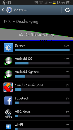

HELP...This is my 2nd S3 as I had battery issues with the previous one and now I am starting to think it has some thing to do with the User than the phone itself. I have 3 other friends who have S3 and have no battery issues. My phone works for less than 6 hours on a full charge and I do everything to make it last. I have BatteryGuru installed with settings set at bare min. I only keep the sound, Screen rotation and Power Saving on, all others I only turn on when I need it. I have turned off all sync, I only have 2 games installed Candy Crush and Solitaire. After using the phone each time I hold the home button and x out all programs. If I use more than one app, I even go to Settings>Appl> Force stop all Downloaded apps and then go to Running and stop all Apps too. By doing this I think I have even messed up my Google Play Store app, now I keep getting an error message that something is unable to access my Google Play store and then my phone starts to stall. If I click on the message or Google Play store icon and nothing come up. I barely use the phone to talk or to play games and don't even open my mail or fb on it anymore. I read 3 news apps each morning for about 30-40min, thats it. I do so much preventive measures and my battery still doesn't last and I have had this phone for only 3mos.

If your phone is dying in 6 hours there may be something else going on that you're unaware of. You haven't provided the bare minimum of information required to be able to look at your issue - namely, the three screenshots of Settings -> Battery:

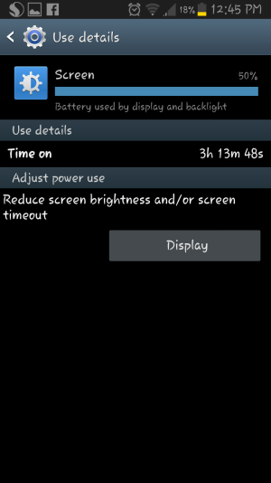

Here is the screen shots from my Galaxy S3.
jannam3000,
There are a few things that stand out about your data:
- your Screen On time is just over three hours, which is pretty good for this phone (without knowing what brightness level you keep it at; in comparison, my Screen On time of barely four hours was at minimum brightness)
- your Mobile network signal is pretty bad (most of it is that dingy yellow; the icon in the upper right barely shows one bar) - nothing will kill your battery quicker than the phone constantly trying to establish/maintain a cellular connection (except trying to establish/maintain a mobile data connection)
- your Wi-Fi signal is pretty pitiful (again, barely one segment shown in the icon in the Status bar)
I'd have to attribute your poor battery life to the lousy signal quality of your cellular and Wi-Fi connections. You could try putting the phone in Airplane mode just to see what happens. (Of course, you won't receive any phone calls or TMs during this time.) You could switch Airplane mode off whenever you need to use the phone or check for messages, and then switch it on again.

You have WiFi turned on almost the entire time. Are you actually connected to a WiFi signal all that time? Leaving Wifi on when there is no WiFi available will use a fair bit of battery while the phone continually scans for a Wifi signal. Other than possibly that, and the weak signals, nothing jumps out at me as an issue. Make sure your screen brightness is a low as you can use comfortably.
And Fuzzy is right. Don't kill programs; let Andoid do what it's designed to do. A program sitting idle in RAM doesn't use any more battery than "empty" RAM.

Yes, I do have poor signal at my home. I barely get Sprint reception so I have it on wifi when I'm at home. I will try switching the wifi off and see if there is any improvement. I am also glad that I do not have to manually kill the apps each time to save some battery! Thank you GSDer and MeyerWeb for your responses, it definitely was a great help for me! :)
