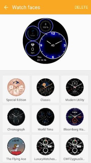

Are you running stand alone at work or connected via Bluetooth or WiFi to your phone? Here is the face I am using and getting great battery

The watch is updated and also connected to Bluetooth at work so it's not in standalone mode. I took it off the charger at 930 today and am not working so we'll see what happens. Also that watch face is the one I am using also.
