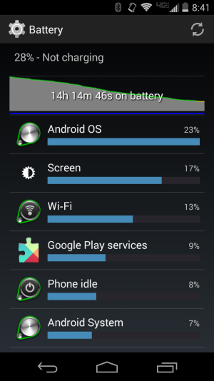

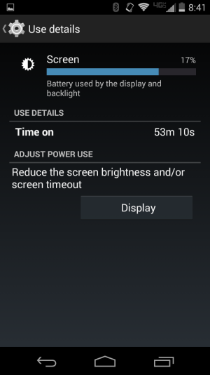

How is this for Battery Life? It seems to me that I used to get way more out of this battery.uploadfromtaptalk1428453853158.pnguploadfromtaptalk1428453864127.png
How is this for Battery Life? It seems to me that I used to get way more out of this battery.View attachment 170051View attachment 170052
Should probably include this.View attachment 170053
That looks like the graphs I used to get on my Samsung Galaxy S3 before I changed it out to my Moto X. I used to get those types of graphs when I used my phone at work in my office. My office has metal walls and it was constantly looking for a signal. Your phone may be having a hard time finding a signal even when you're on a Wi-Fi connection. My Moto X does a lot better in my office than the Galaxy S3 ever did.
Looks like something is keeping the phone awake,while the screen is off by looking at your "History Details" graphs.
It shows its not awake for very long but quite a few times while the screen is off from graph details
Have you checked to see how often your apps sync ?
Something else that you may want to check out on your phone is what you have the battery mode set to. I've got mine set to Balance Mode and it does just fine. It also has a Power Saving mode that you could switch it to if needed.
try turning wifi off when not in use and do not let google scan wifi for location.
I highly recommend using the free app Greenify.
It is not a gimmick and really works. Takes a little bit to understand at first but basically you install it, tell it which of your installed apps you want it to hiberate when not in use, and it does so automatically or by an easy button shortcut.
You dont require root but if you by chance are rooted then it goes even farther by letting you hibernate system apps too.
I have it on my phone and tablet. Inreases by battery life by 20%.
