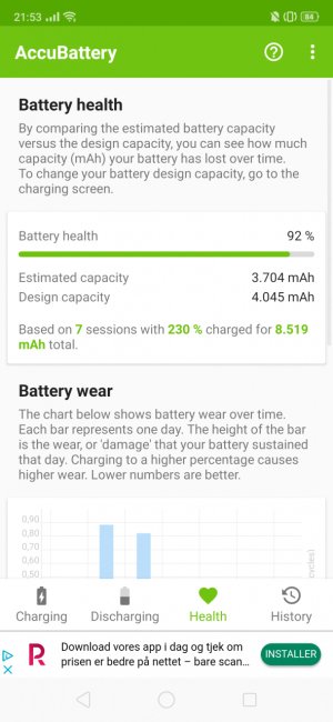

I bought a Realme 5 Pro 3 weeks ago, and the phone is as expected.
I use AccuBattery, and when I checked the health of the battery it was only at 92%.
The specifications state that the battery is 4045 mAh. AccuBattery has it at 3705 mAh.
I find it odd. With the last two phones I’ve had, AccuBattery stated the health pretty consistant at 101-104% even though they were 2 years old.
Is this something to worry about? I feel like I might have bought a faulty phone.

-You- have to set the size of the battery in Accubattery.
Charging page>bottom of page, punch the Set Design Capacity button>enter rated bat capacity
Without this data it can't do some functions properly...
You may want to clear all data -before- you do the above as some the data it has already collected is erroneous and will adversely effect it's predictions and accuracy.

AccuBattery should detect the design capacity of the battery during the initial setup. The only time you'd want to change it is if you have a phone with a user replaceable battery and you swapped in a larger capacity battery.
To JakobM, it's common to see brand new Li-ion batteries with lower than rated capacities. I've personally never had one right at 100% out of the box, and have always stuck with flagships from major manufacturer. From https://batteryuniversity.com/index.php/learn/article/how_to_prolong_lithium_based_batteries
Although a battery should deliver 100 percent capacity during the first year of service, it is common to see lower than specified capacities, and shelf life may contribute to this loss. In addition, manufacturers tend to overrate their batteries, knowing that very few users will do spot-checks and complain if low. Not having to match single cells in mobile phones and tablets, as is required in multi-cell packs, opens the floodgates for a much broader performance acceptance. Cells with lower capacities may slip through cracks without the consumer knowing.
In one of their test of 11 batteries, they all had initial capacities of 88-94%, putting yours at the high end of average. The phone may have initially had an even higher capacity, but naturally degraded a bit while sitting on the shelf for months. Yours was released last August. I'm currently using an LG V60 released only a month ago, and it was about 94% of rated capacity from the start.
Did that, when I powered up the phone the first time and downloaded my apps from Play store.

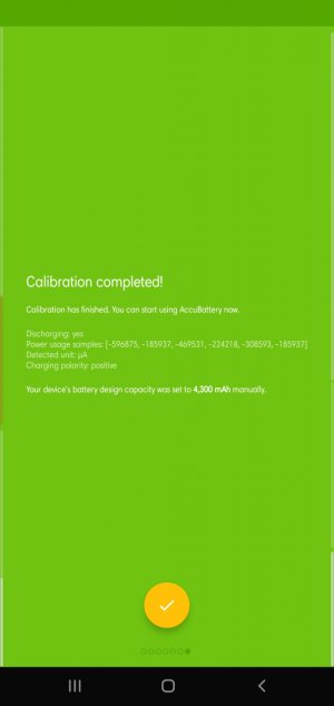

I have the paid version and there's no auto detect for the factory bat spec. Maybe so on some devices but certainly not this one, Note 10 plus running on Pie.
When you do the initial setup and go through the tutorial, the final screen is the calibration step. It will detect the design capacity from the phone here (or at least initially display it) and show you what it thinks that capacity is. (Refer to my screenshot for example.) You can change it later if you wish, but I've never needed to on an OEM battery.
As for some batteries being estimated above 100%, that's certainly possible. No two batteries are exactly alike, even if they come off the production line back to back. There's variables that could allow them to have different true capacities despite the design capacity. The advertised design capacity is something of an average, not an exact amount one can expect. That's also not factoring in all the variables that additionally come in to play between when the battery comes off the production line, to being shipped to the phone manufacturer, to finally arriving in your hands.Screenshot_20200507-160408.jpeg

Minimum acceptable level? I got that same screen on tutorial where you said to look. The set up is locked unless I delete the current data so it runs the set up again.
Not sure what it's using maybe off the power controller or battery pack?
Your screen shot shows that it was set manually as well?

Only on the second screenshot. The one I posted before was with the automatic detection.
Your screen is showing exactly the same albeit the value.
Since I manually entered it I think it's defaulting to that value; initially it was slightly lower. I corrected it.
The correct rated capacity is what matters.
It sets the baseline... ha-ha life's not fair.
