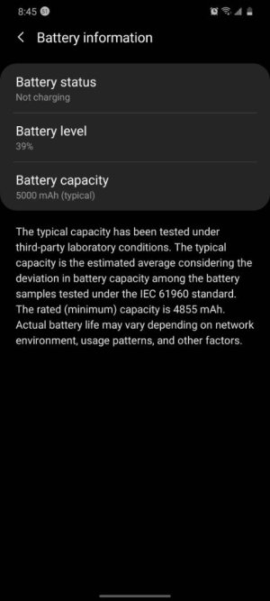

Well, multiple capacity ratings do exist. The minimum rated capacity is based on an IEC Standard. Many of us discovered this the last time a similar discussion was held. See attached from the S20 Ultra settings. It matches what I stated.
