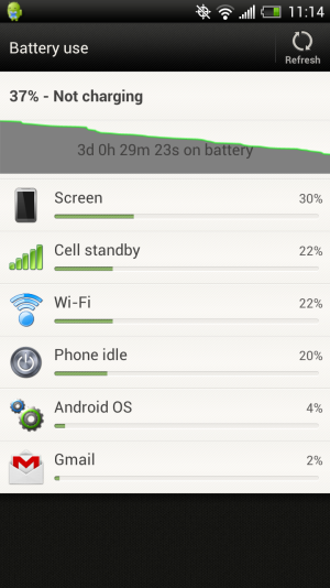

Here was a link to one of my previous magical 3 days battery lifes.
http://forums.androidcentral.com/at...r-2-months-screenshot_2012-08-29-07-23-40.jpg
one can see that android OS USED to be 4% of use. Odd.

What is odd though is that items like Good for enterprise, calendar, downloading apps, using the built in email app don't show up here?
I would say my battery life is back to where it was prior to the update, seems like it was other issues draining the battery.
What is your screen on time? Please click the Screen entry on that battery Page. Please post screenshot.
