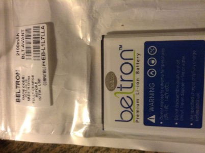

I just went and brought a new battery for my phone and the charge goes up pass 92 to 93 and will stay on that percentage through the
the night so i have two batteries both are different one is from Samsung and the other is from a company named beltron but now their saying its the same battery like hell it isn't the original battery charges to 100 percent in about two hours but the new one never made it to 100 in over 18 hours so how is this better or the same for that matter .
I understand slow charging but this is ridiculous
