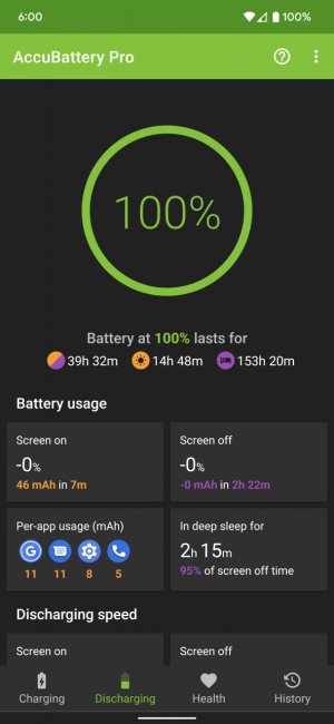

I did a factory reset as previously stated. Checked Accubattery to confirm Deep Sleep was activating with the stock Android apps. I did uninstall or disable stock apps I don't use. Deep Sleep was still going strong. Then downloaded all my other apps with the exception of social media apps. I'll add those later if I keep seeing positive results.
Charged phone to 100% and in 2 hours I've lost 0%. Deep Sleep doing it's job.
From 4 PM to 8 PM I've lost 1% in 4 hours of idle time.
I have Bluetooth, GPS, LTE, NFC, and Smooth Display all OFF. I'm using an eSIM as well.
