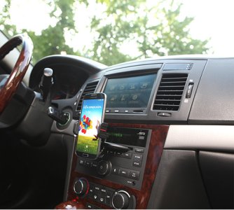

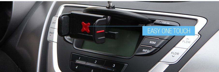

I have this ExoMount Touch CD. It is very secure and the location is ideal. I don't use my CD player anymore. I found windshield and dash top mounted mounts a bit of a reach for my arm. Where the CD slot is high enough to keep my eyes on the road and close enough to comfortably reach. The spring loaded clamp makes placing phone in a breeze. Highly recommended
ExoMount Touch CD Slot Mount for iPhone 5S 5C Galaxy Note 3 S4 Smartphone
