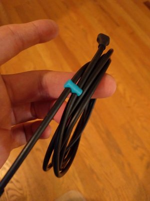

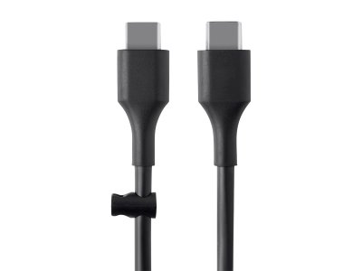

I bought a usb-c to usb-c cable from the google store and it has this blue connector/tab thing on it that for the life of me I can't figure out it's purpose. I know that another part of the cable can snap onto it, but why?
For a photo here's the same thing except on a monoprice cable View attachment 207806
It's a builtin "wire tie."
Loop up your cable. Snap in the other end to the clip... voila! No unraveling cable.

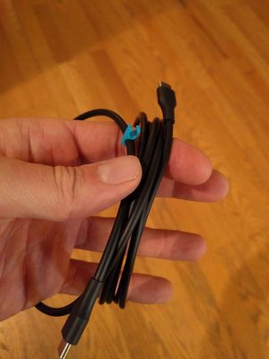

I get it that it's a wire tie but I've tried it and it doesn't work very well. A typical wire tire goes around all the other wires when looped, this just attaches to one. I tried it and the loop just unraveled.... I guess I'm doing it wrong.
Loop your cable so it stacks on top of itself. Then cross the two ends over the top, and clip together. It should hold the loops together so they don't unravel...
1. Loop cable
2. Crossover ends
