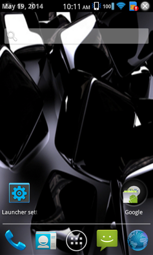

What is this?
This is a modded stock ROM built both for speed and stability. This ROM is based off of the LG's ZVA update. It is fully deodexed, and debloated.

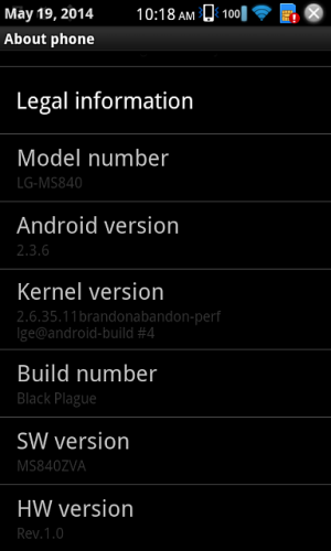

Screenshots
