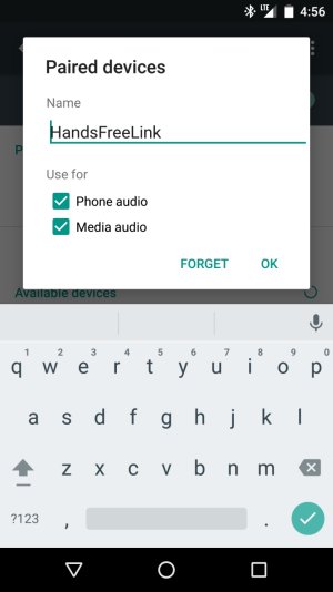

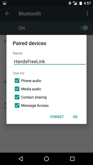

I can call out, but I do not hear the number dialing and it seems like nothing happened.
When I look at my Bluetooth pairing settings, I briefly see this:
Then, I quickly see this:
