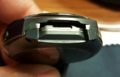

Today, I was looking at how the latching band on my watch was feeling slightly loose. So I took the band off and noticed something. It appears that a piece of the tip of the connector (for a lack of a better word), may have somehow broken off. Can anyone confirm this by looking at their watch? By the way, this is the Wi-Fi only version. Thanks!
If it is in fact broken, I'm hoping Samsung has an RMA process similar to Motorola...which was easy peasy when I needed to RMA my OG 360.
That looks fine to me. I don't think it is broken. Most likely you have a loose screw on the band itself where they click together. This is a known issue and you need to check it regularly. Just get an eye glass repair screw driver and tighten it when it gets loose. Hope this helps.
Thanks! I had no idea this was a known issue. As usually, the support we provide to each other is always AWESOME! Thanks!
Confirmed! That was the problem! Huge Thanks!
