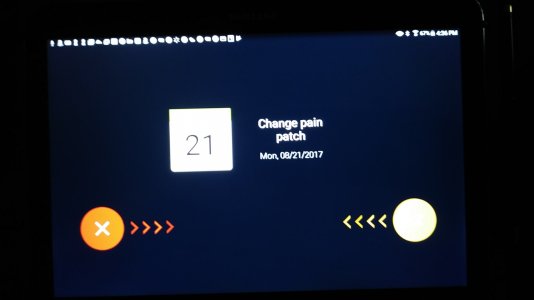

I own a LG K20 in which android 7.0 came on it. I use Google calendar all the time. On all of my other devices when Google calendar reminds me, it comes up as a black screen with a red ball with a x in it and if you swipe it to the right it stops reminding you. And there's a orange or yellow ball on lower left corner. You swiped to the left and then the next time you started your device it reminded you again. That is now missing from Google calendar on my android 7.0. Now the reminder is pretty much un-noticeable. I want reminder back. Please! Or let me know how to get it back.20170821_162920.jpg
