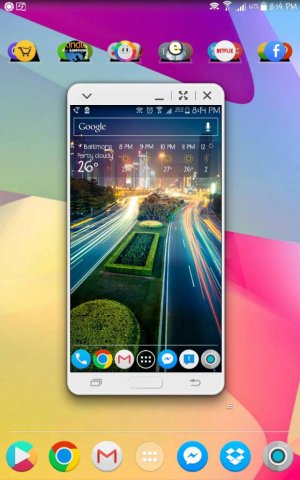

Phone was about to die, but I'm waiting on an important text convo... so, I decided to try out Side Sync on my tablet while my phone charges in the other room. This is extremely cool and convenient. Thanks for the info!
looks cool...I wished it would work for me except it drains battery for me.

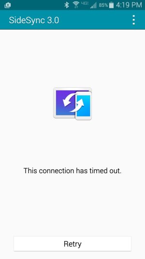

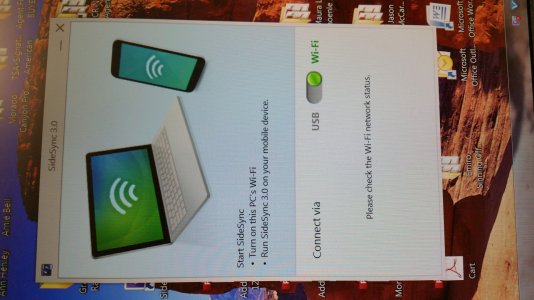

I just d/l SideSync on my phone and PC and unfortunately I couldn't even test it out as my Note 4 couldn't connect to my computer wifi network. It kept saying "couldn't connect, try again".....hmmmm, I use Push Bullet just fine, no usb cable. My computer is hard wired to the wall internet and wifi connected.
Make sure both devices are in the same network and IP range. Sometimes you might need to restart both devices to refresh the IP address.
I'm doing something wrong......I restarted both phone and PC. Here are the screens I get on my PC and Phone.....I have my phone on wifi, my office. I'm not sure what else I can check......the screen that shows on my computer says "Please Check the wifi network status?
Mmmm..that's odd. I'm not on WiFi at the moment, but when I get home I'll test it out (I honestly have only used SideSync over WiFi with my tablet and it works just fine; with the PC I always use USB).
Thanks SpookDroid, appreciate it!
