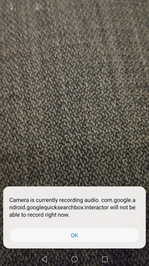

I'm getting this pop up notification when I use my camera for video (also when I use the Ring app which also uses the microphone). I didn't get it in the past. What part of Google did I change that is causing this? Anyone know?
The annoying part is that it will pop up repeatedly and I have to dismiss it to do anything with the underlying app.
(fyi - I just aimed the camera at my jeans for that picture)
OK Google is set to detect from any screen. You'll have to turn. That off and set it to only detect in the app since the camera is taking over the microphone.

This is strange because I could swear it didn't appear before I reset the phone but it's quite possible I didn't have detect OK Google on from any screen. Hmm... have to weigh convenience against annoyance now.

I find it just as easy to hold the home button and say it honestly
Oh yeah! That is a good compromise! Perfect. Thanks!
No problem. I'm learning when you buy unlocked phones from someone other than the Samsung's, lg etc there's a few quirks here and there. So far on this one I haven't found anything too drastic that makes me want to go back to those other brands...Yet.
I think the Google Assistant update fixes the issue. On a lark I re-enabled "Ok Google From Any Screen" and I've yet to run into the issue with any of the apps I used before. Give it a whirl and report back.

I don't think it's Huawei, I think it's a program related issue. I had one oddball issue appear out of the blue. I started using Duo and thought I had disable Ok Google On Any Screen, and got the microphne nag. Went inside Assistant and physically disabled it backed out, went back in again, and once again it was enabled. Disabled, then went into the Google app and double-checked the "Google Now" Ok Google settings... sure enough it was auto-enabled and there was now way to turn it off. The only resolution was to delete my voice learning. Then I could disable the setting fully.
I'm wondering if the Assistant and the Google app (which is part of the phone's base installation packet... there's no way to remove it) and are both fighting to use the mic. Just odd to say the least.

I think it's anything that tries to grab the microphone. For some reason, it wants to tell you that you can't say "OK Google" while you are using the microphone for something else. Clearly it wasn't planned because it's all in program mishmash rather than a friendly notification using layman's vocabulary.
Pretty sure this is an Goggle Assistant/Google Now software issue. If you go to Google's Assistant forums there are a lot of devices reporting similar problems. Some Samsung S6 users have been reporting the mic refuses to shut off and keeps recording audio, other Samsung users are reporting they cannot open apps because Ok Google is in use.

Go to :
Setting } Apps } Google } Permission } deactivate Microphone .
So that will deny Google app from using Microphone and this message will stop appear .
