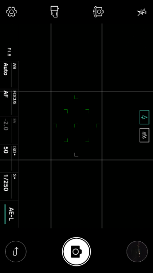

When in auto mode, you're at the mercy of the programmers and what they think is best. The only way around this is by using the manual controls. I'm not familiar with yours, so I'll show you how it looks on my LG V20 and you'll likely see a similar layout on your phone.
On mine, I can switch to manual mode and it'll still use an auto exposure similar to if I were still in Auto Mode. But this is where that EV meter I mentioned comes in handy. When auto exposing, cameras try to compensate for lighting to make things neutral, not necessarily what your eye sees. In the case of a dark setting, it'll try to expose so everything is brighter and you can clearly make out the details. There's a couple ways to address this if it's not to your liking.
The EV (exposure value) meter.
This is the easiest, one adjustment method to use. The camera normally exposes so this meter reads 0 (zero). Positive numbers are over exposed, negative numbers are under exposed. If in manual mode using auto exposure (or any mode that may have an EV option available) and it's too bright for your tastes, reduce the EV value. The camera will make the necessary adjustments to give you a darker than normal image. The lower you set this value, the darker it'll be and vice versa.
The other way is to manually control the ISO and shutter speed. (If you run across aperture control advice, that doesn't apply to phones, as they have a fixed aperture that you can't change). Reducing either value makes an image darker, and vice versa. You'll notice in my above screenshot my EV meter is greyed out. That's because I had manually locked in the ISO and shutter speed. So instead of using it to control the exposure, it's now giving me feedback on the changes I'm making. In that case, I was severely under exposed so I had a black image for the screenshot.
