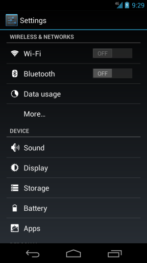

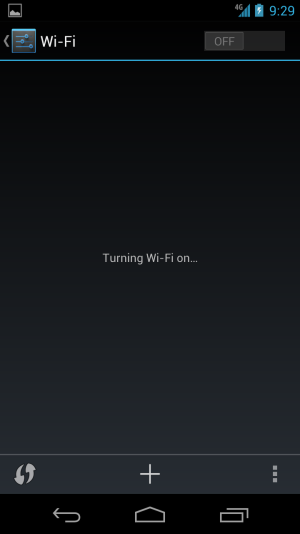

I got the Jellybean OTA update for my VZW Galaxy Nexus on Saturday. The OTA downloaded over Wi-Fi and installed successfully. Once I was booted into Jellybean I noticed that Wi-Fi was not displayed in the status bar. I went into the settings menu and found that the Wi-Fi On/Off toggle was gray and could not be toggled. Then I went into the Wi-Fi settings and was greeted by the message “Turning Wi-Fi on...”. No matter what I do Wi-Fi never turns on.
