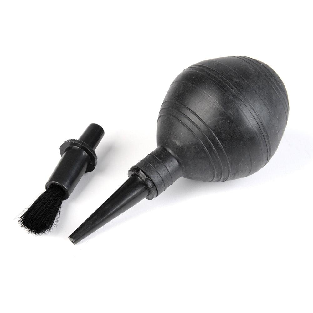

rvbfan
Jan 17, 2015
1,231
403
83
Visit site
A little camera cleaning kit works well.
Got mine at a dollar store . It was only a few bucks.
