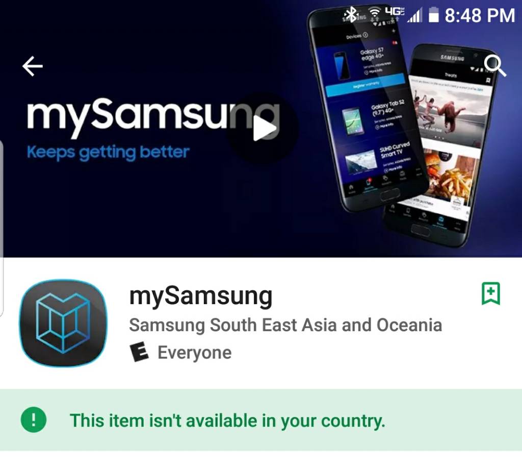

cannot access internet in some apps.
Need a bit more info. Android version, rooted or non rooted. If it was rooted before, was KNOX tripped?
What country are you in?
Aside from the app you posted the screenshot, what other apps aren't working?
If that is the MySamsung app found in the play store, it states that it is only available South East Asia and Oceania. If you managed to get it loaded on your phone, it won't work anyways.
I use the Asian version. I didnt root and it happens it other apps too. Like samsung themes and samsung pass. Or Fildo. Clear data and reinstall does not work. But when I do a soft reset everything works.

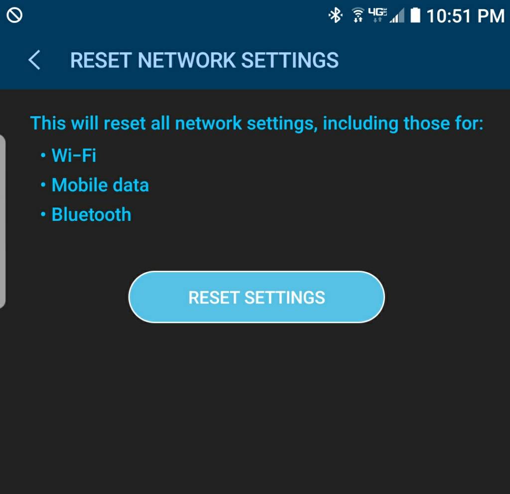

Maybe try going into your Backup and Restore, and run a Reset Network Settings.
After that, reboot into recovery and try to manually clear your cache.

Thanks! It works! I contact the customer support and they tell me to factory reset every time.
I'm glad that helped.
But, just remember that customer support is just giving you the information that Samsung tells them to give.
Factory reset will eliminate most issues customers call in about, and instead of taking the time to troubleshoot, suggest a network reset, etc, they just go straight for the nuclear right away.
