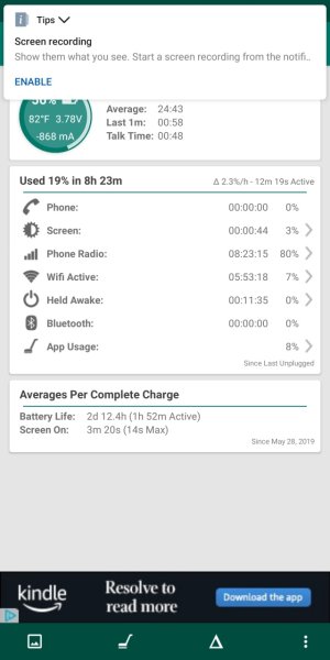

The basic GSAM stats:

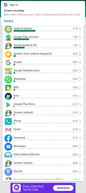

The individual app view( this says this list only accounts for 7.8% of battery consumed, it got covered by that notification)

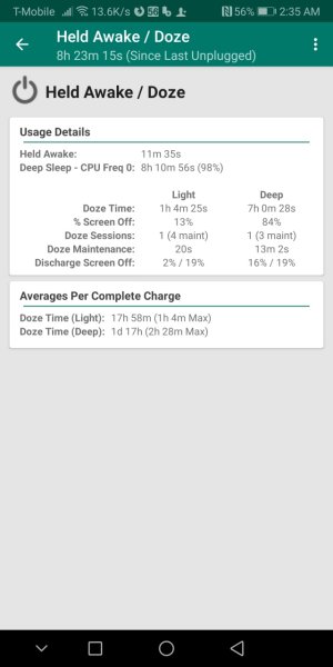

the doze stats:

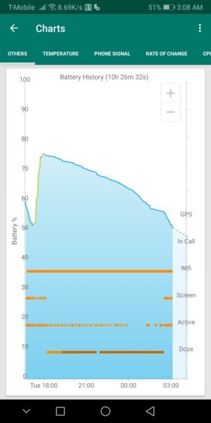

GSAM graph: (cannot explain the battery drain during doze)

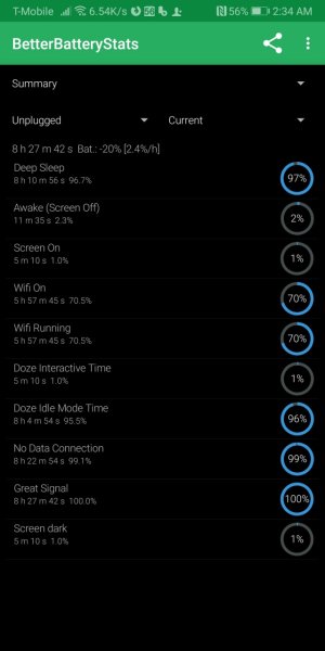

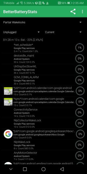

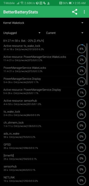

The BBS stats

what's confusing me the most that gsam can't account for the battery drain.
It’s telling you that 19% of the battery charge was used overnight, and that the phone radio and WiFi together used 87% of that; but you mean that you can’t see how that can have happened, given Doze and the switched-off Settings you mentioned earlier?
From the graph, something is obviously repeatedly happening under Active throughout the night, and it’s that that’s baffling you?
yes exactly, every-time I pick up the phone I can see it connect to wifi/mobile data which clearly turns off when i stop using the phone.

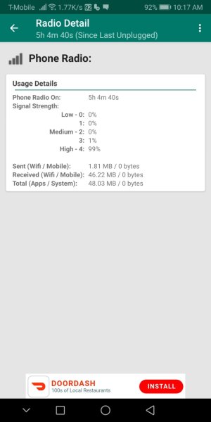

Here is the screenshot of the phone signal :
There isn't even a case of a low signal where its needs to be amplified

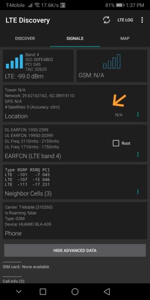

The phone radio is using 80% of the battery usage. that tells me that you have a weak signal, and that's causing the drain. (If the received signal is weak, it's assumed that the phone's signal at the tower will be weak, so the phone radio is transmitting at, probably, its highest power.)
Either you put the phone down in a dead spot at night (and a dead spot can be a few inches in diameter), or you're using the wrong carrier. Install LTE Discovery and see what the signal strength is. (The number should be 100 or smaller - it's a negative number, so the smaller the number, the stronger the signal.)
Here is the screenshot from LTE discovery
