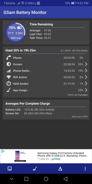

I have just factory reset my phone and am posting screenshots of all my battery monitoring.
https://imgur.com/a/vfa4SGo
Please help me identify what is causing this battery drain.
So what I have noticed is that the drain is way worse on wifi than on mobile data.
Regardless in both cases, the drain is shown under 'phone radio' but its 4-5% per hour on wifi and 1-2% on mobile data.
That's why I asked you early on if you could be just on data , I think your issue is on wifi .
