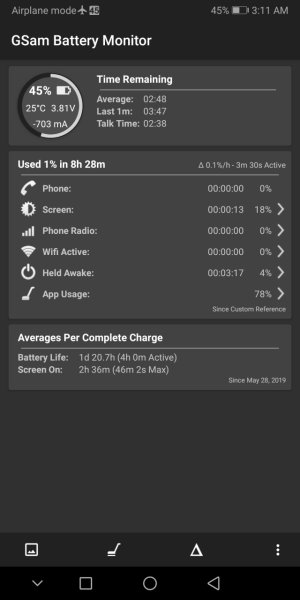

Last night I left my phone on airplane mode while sleeping and it lost only 1% which is consistent with what I used to get before. I should be getting a similar performance without airplane mode.

yes, the airplane mode was just a control test just to confirm there was nothing else wrong. Now I'm going to further test this.
Going to leave my phone untouched for 3-4 hours with wife on data off and wifi off data on, the battery loss should be 0-1% as I used to get in both scenarios. Let me post back with what results I get

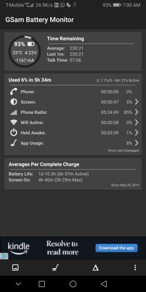

This was with WIFI ON , DATA ON , LOCATION OFF (no change still the same battery drain)
This was with WIFI OFF, DATA ON , LOCATION ON (no change still same battery drain)
I'm going to run wifi on and data off now but this seems to be a cell standby/phone radio issue.
The phone radio is using 80% of the battery usage. that tells me that you have a weak signal, and that's causing the drain. (If the received signal is weak, it's assumed that the phone's signal at the tower will be weak, so the phone radio is transmitting at, probably, its highest power.)
Either you put the phone down in a dead spot at night (and a dead spot can be a few inches in diameter), or you're using the wrong carrier. Install LTE Discovery and see what the signal strength is. (The number should be 100 or smaller - it's a negative number, so the smaller the number, the stronger the signal.)

And it's definitely not a weak signal, -99db is a pretty strong signal. (And you get the same drain just using WiFi., which as nothing to do with the cellular signal strength.)
