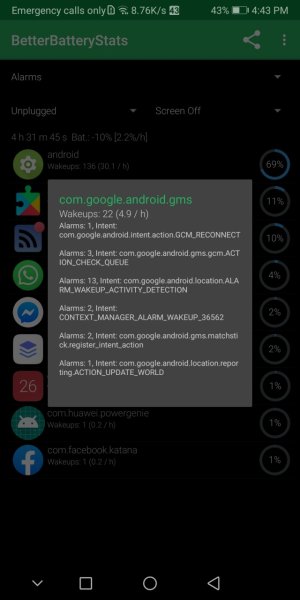

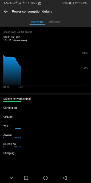

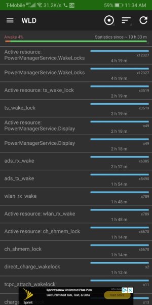

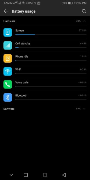

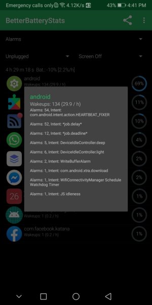

I have just factory reset my phone and am posting screenshots of all my battery monitoring.
https://imgur.com/a/vfa4SGo
Please help me identify what is causing this battery drain.
Yeah don't see anything from there , what I'm thinking is something in system that's hidden from these battery monitor stats , if you dont mind can you post a screenshot of the stock battery stat monitor.

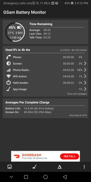

Ok, so I just removed the sim , restarted the phone and enabled wifi.
This is what I got :
I cannot understand what would cause this.
I guess that means that it was trying to connect to a carrier signal, and could not without a SIM. With mobile data switched off as well, it would presumably be unable to search, but perhaps you did indeed have it switched off?

once the sim was out, mobile data and everything related to phone signal were greyed out in settings (disabled). So I don't know why the battery usage is being shown under phone radio.
That's very strange. That battery usage under phone radio shouldn't happen with the SIM card out and disabled. You could try this, just in case Gsam is misrepresenting the stats.
