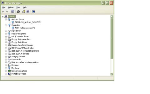

I have USB debugging enabled. phones does show usb icon in notification bar. computer shows phone connected in device manager. not sure if device manager shows adb device. here is what I have. also i'm running on windows xp, so do i need to set something as administrator mode for that os?
