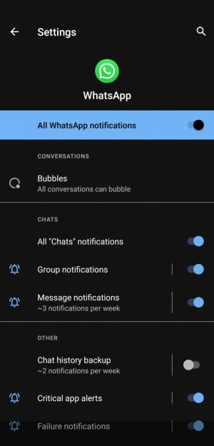

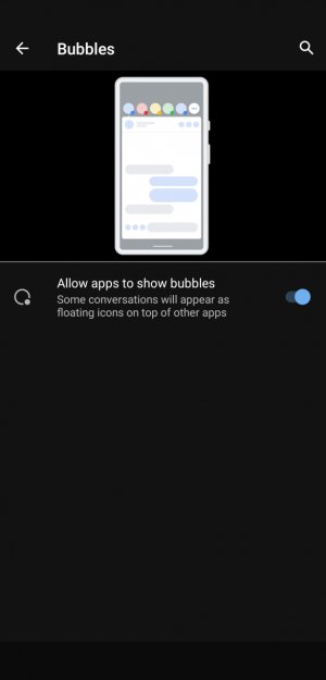

I have a problem getting bubbles with WhatsApp to work. I have bubbles enabled and in WhatsApp's notification settings I have it set to 'all conversations can bubble' but the icon to 'bubble' it won't appear in the bottom right of the notification. I tried reinstalling it and restarting my phone but it simply refuses to work. With telegram it works just fine as with other apps that support it but not WhatsApp. What could be the issue?
