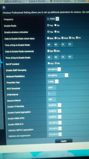

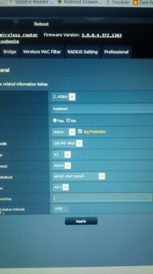

For those who have the same router Asus here are the settings that I have
I hope this helps
Sent from my Z10 using AC Forums mobile app

Thanks, KIDKAMEL. I just replaced my router with the ASUS RT-N65R. Your settings will be useful as I troubleshoot my CHROMECAST connection issue. CHROMECAST worked just fine with the previous Motorola gateway.
