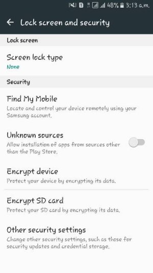

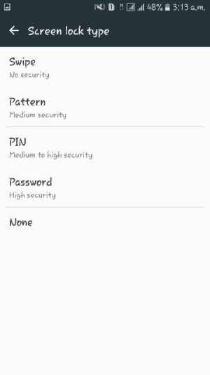

When I try and set my lock screen to anything besides swipe to unlock, it will not register it. For example, I set up for pin & Once I lock my phone, it can be unlocked with just a swipe. I've tried the other lock options like the pasword and pattern but I have the same outcome. I've update my J5 from lolipop to marshmallow recently.
Please help. Thanks.
Welcome to Android Central! Are you sure the time interval between when the screen turns off and when it locks is set to something short? It's usually in Settings>Lock Screen>Automatically Lock​.

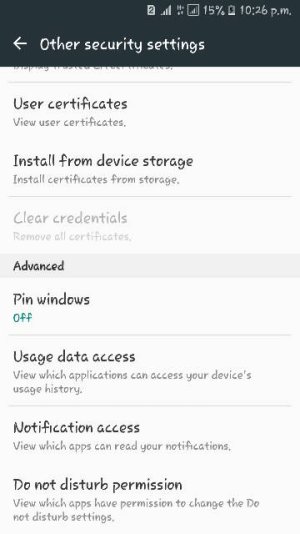

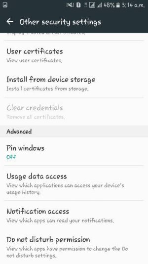

If you go to Settings>Lock Screen & Security, what options do you see? Is there an Other Security Settings? What's in there?
In other seurity settings,
1.set up sim card lock
2.security policy update
3.device administrator
4.storage type
5.view security certificate
6.user certificate
7.install from devise storage
8.clear credential
Anvanced
Pin window
Usage data acces
Notification acces
Do not diaturb permision
Set the screen lock type to password or pattern. Then look at the Lock Screen & Security menu again. See if the Automatically Lock option shows up now.
