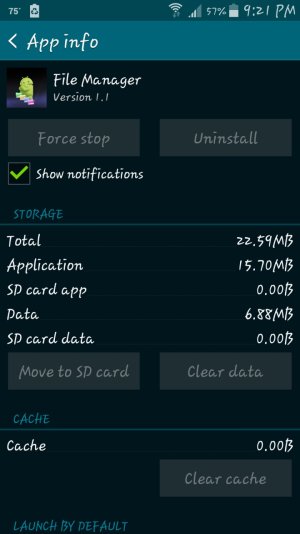

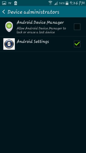

I tried to download a third party app but a different apk downloaded instead and installed because I wasn't paying attention to the name of the app on the screen when i tapped install. So now i have an app called file manager and my phone will not let me Uninstall it. When i go to the application manager its listed but the Uninstall button is grayed out and will not let me even clear default or data. File manager is not even listed in my app drawer. I try to Uninstall it from sandisk memory app but it says i cannot Uninstall it because it's a device administrator. So i go into device administrator but file manager is not listed. I've uploaded pictures to help diagnose this issue. uploadfromtaptalk1434159580409.jpguploadfromtaptalk1434159597112.jpgDoes anybody know whats going on and how to fix this? Thanks

Has that "Android Settings" always been there in the Device Adminisrators? I've never seen that in any of my devices. Try unchecking that, then try uninstalling the File Manager app again.

To fix this NO RESET required! NO ROOT REQUIRED
1. Open settings
2. Go to "Backup and rest" (In the settings app)
3. Uncheck the "Automatic Restore" and the "Backup my data"
4. Go to "Security" (In the settings app)
5. Go to "Device Administrators (In the settings app which is in the security tab that you opened earlier)
6. Find "Android Settings" and Uncheck it. (The android settings is the file manager)
7. Go to "application manager" the open the "Downloaded" tab. (In the settings app)
8. Lastly scroll down and find an app called "File manager" with an Android on it. Open and uninstall.
9. You may turn on "Automatic Restore" and "Backup my data".
No more adware. I hope this worked... It worked for me.

Ok you have to install root jninstaller.
1. Go to Settings- Apps- App. Manager- Running tab- File Manager- Stop.
2. Settings- Security- Device Administrator- Android Settings - Deactivate.
3. Open Root uninstaller- 3rd Apps- File Manager- Uninstall.
This worked for me.
Hope this work for you!☺
