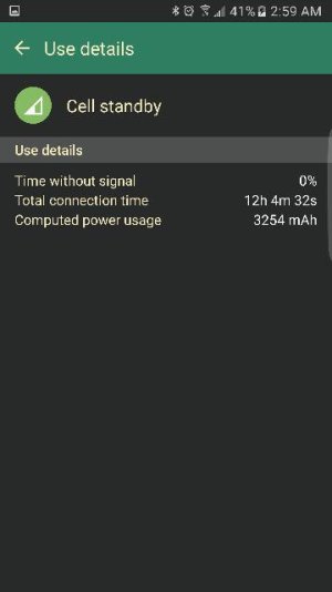

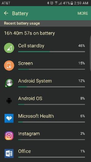

Hey guys, i had this phone since launch and its been about 2 weeks of me suffering from cell stanby drain. Im currently at 46% 😧 plz help im new to Android
16hrs, 59% battery used. That's not intense stanby drain. You just have nothing else using the battery that much. Nothing else is running, hence that's the highest battery usage. Play a game for an hour then you'll see cell standby decrease to be replaced by screen.
Lol not really, this is when i was charging it. My battery is at 20% by 6pm everyday
20% down since i unplugged at 8:20am
Also dont you think 3200mah used by this isnt excessive? The phones battery is 3600...
Wait, so it's actually 80% in 10hrs? Ok that's not normal.
And yes 3200mah is a bit high.
Get GSAM battery monitor, full charge the phone and let it cycle that way a couple of times then post the results.
