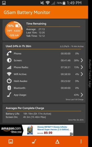

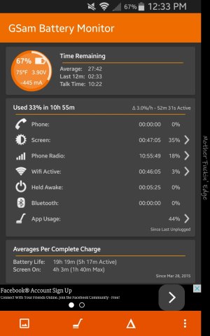

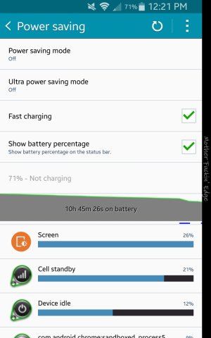

edit: here are some screenshots. Battery dropped from 100-78% with around 5 mins of screen time. The rest of the screen time and use is from me looking for solutions online
Screenshot_2015-03-29-12-33-40.jpgScreenshot_2015-03-29-12-21-25.jpgScreenshot_2015-03-29-12-21-32.jpgScreenshot_2015-03-29-12-21-38.jpg

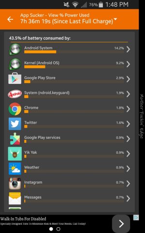

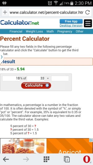

Boot into safe mode, which disables 3rd party apps, to see if you have a rogue or runaway app. According to one screen shot, cell standby used 21%of the 21% if my math is correct, cell standby used only 3.5 % of the 21 % used in almost 11 hours. In the other s/s 18% of the total 33% is about 5% in almost 11 hours. Maybe its just me but tha doesn't seem unreasonable.
Your "other apps" used 44% that's what i would be looking at.

You are right, I took these screenshots after using the phone for a while. I should've taken them right after I woke up to show the phone radio using 80% of the battery while the phone is idle. I know its normal for the radio to use the bulk of the battery juice while I'm not using the phone because its the only thing on, its just that the radio used to not use 18% of the battery on its own.

Then i would definitely, suspect an app using the radio, maybe in the background. I wish you would have gone on an tapped the 44% app usage, the see just what was using the most there.

I knew there was a screen I forgot to screenshot! It wasn't anything out of the ordinary, so I probably ignored it. There were no third party apps showing on it. If it continues to be a problem, I'll look more into it. I wonder which apps would need access to the radio, hmm. I'll have to go through them all when I'm through testing safe mode.

In the top left corner of Gsam, in the circle with the battery info it says "-445 Ma" for example. Is this the current discharging rate of the battery?
Mine says 450, not -450.

Here are some updated screenshots. It might be a little better today, but I only have 30 or so minutes of sporadic screen on time. I used to get around 30 minutes from 100-90%. I guess I will just have to suck it up because nothing is showing up in app usage, and nothing is waking it. Maybe it will improve over time. Or maybe something is wrong with my hardware. I guess airplane mode is a fix in a pinch, but then I don't receive messages or calls.
