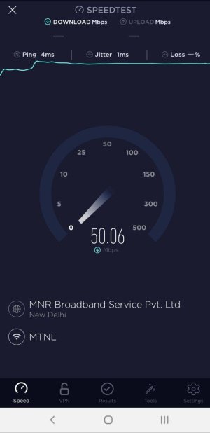

So my setup for using note 9 / Smart TV is something like this:
Alphion 1601 GPON Router/ Modem provided by ISP (In which the optical fibre cable is plugged in)--------TP Link AC 1900------ Phone/ TV
THe Alphion GPON Router/Modem also has Wifi (Single Band)---The wifi range with this is less and I get low speeds.
So I bought the TP Link Archer A9 AC1900. This has been setup only as an access point mainly to extend WIFI around the house and get higher speeds with it
When connected with Wifi of the ISP router/modem I get lower speeds
In both cases (Direct ISP Wifi and TP Link Wifi) I am unable to connect with the android apps and their websites.
I am attaching the screenshots. Have tested wesite version of these apps on different browsers. Still not working.
Spaceboy.

Your connection looks good. If you have done everything above, and it's a few apps, my last advice is to delete the apps in question, clear the cache partition and reboot, reinstall the apps.
If still not working, other than your region being blocked for those apps, or I don't know.
Others may have additional advice if the above does not work.
Good luck
