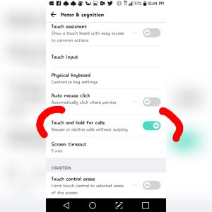

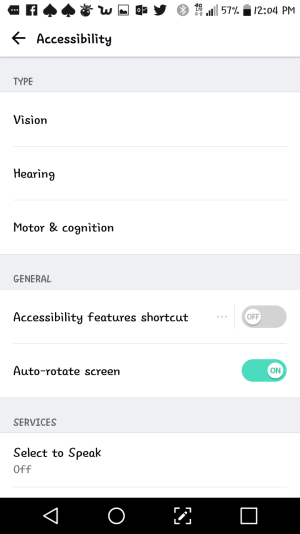

My new LG Fiesta 2 with Walmart Family Mobile lists "Settings" "Accessibility" then "Motor and Cognition" then Touch and Hold for calls - answer or decline calls without swiping. Hoping that will work - it should.

I have an LG G5 and just chatted with a rep. Here is the answer:
You can change the call answering settings. Go into Settings-Accessibility-Click Dexterity and interaction, then you have the option to select Touch and hold calls/Answer or decline calls without swiping;)

I just did something and have no clue what it was but I got it to where it is in a box There are 3 boxes answer....ignore with message.....ignore It was in setting accessibilty Dexterity and Interaction Hit touch control area and turn it on but once you turn that on The touch assistance turns off. I can't guarantee this is what did it for me but no more circle swiping stuff
