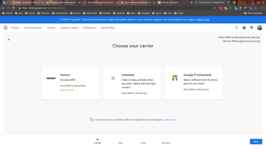

What's the exact model number of the phone? Do you know if you ordered the Verizon variant from the Google Store, or was it the completely unlocked one?
