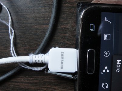

Here is a picture of how to open the port cover:
Notice how the port cover MUST remain parallel to the connector and at no more than a 90 degree angle. The plastic tab connecting the port cover to the s5 does not have enough elasticity to be twisted up, down or more than 90 degrees without stress and possible breakage.
It is best to make the connection on a flat surface like a table or desk.
The witrigs site has replacement covers and appropriate screw drivers for a reasonable price. However, unless the connector is inserted EXACTLY like shown above, they will continue to break.

Thank you for posting that image though. I wonder how many of those that have broken covers followed that advice or pulled further. I have done it as you show since day one with no issues but that's not to say others haven't. :)
