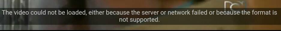

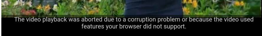

Why they release a phone and then firmwares with problems? , move from a S5 (crappy 5.1.1) firmware update, to the M9, two days later I decide to update to the 5.1, battery life is to short, but the worst is the charging, very slow. But now I'm getting some network cutoffs, played videos, but after minutes it's stops. Any feedback....
#BlameTMO
#BlameTMO
Read the error messages and there is your solution. Simple.
