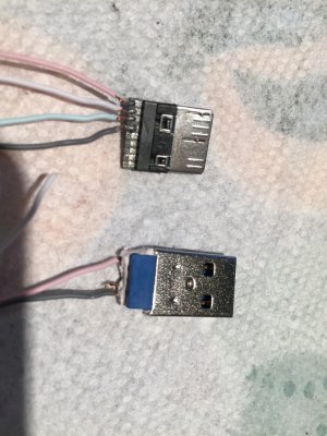

bought a couple USB3 cables and one had an intermittent problem where when it was bent one way it would disconnect charging so I stripped it apart. was surprised to see that the cable ONLY uses the 4 microUSB pins. The cable itself only had 4 pins and yes it also worked transferring data. Note that in removing the connector covering, two cables came off the usb end. you can see clearly only the microusb side of the USB3 cable was used. Only 4 wires in the cable. Not willing to strip out a genuine Samsung USB but wonder if anyone else has?
I have one that the cat has chewed to death. I'll see about stripping it later tonight.
