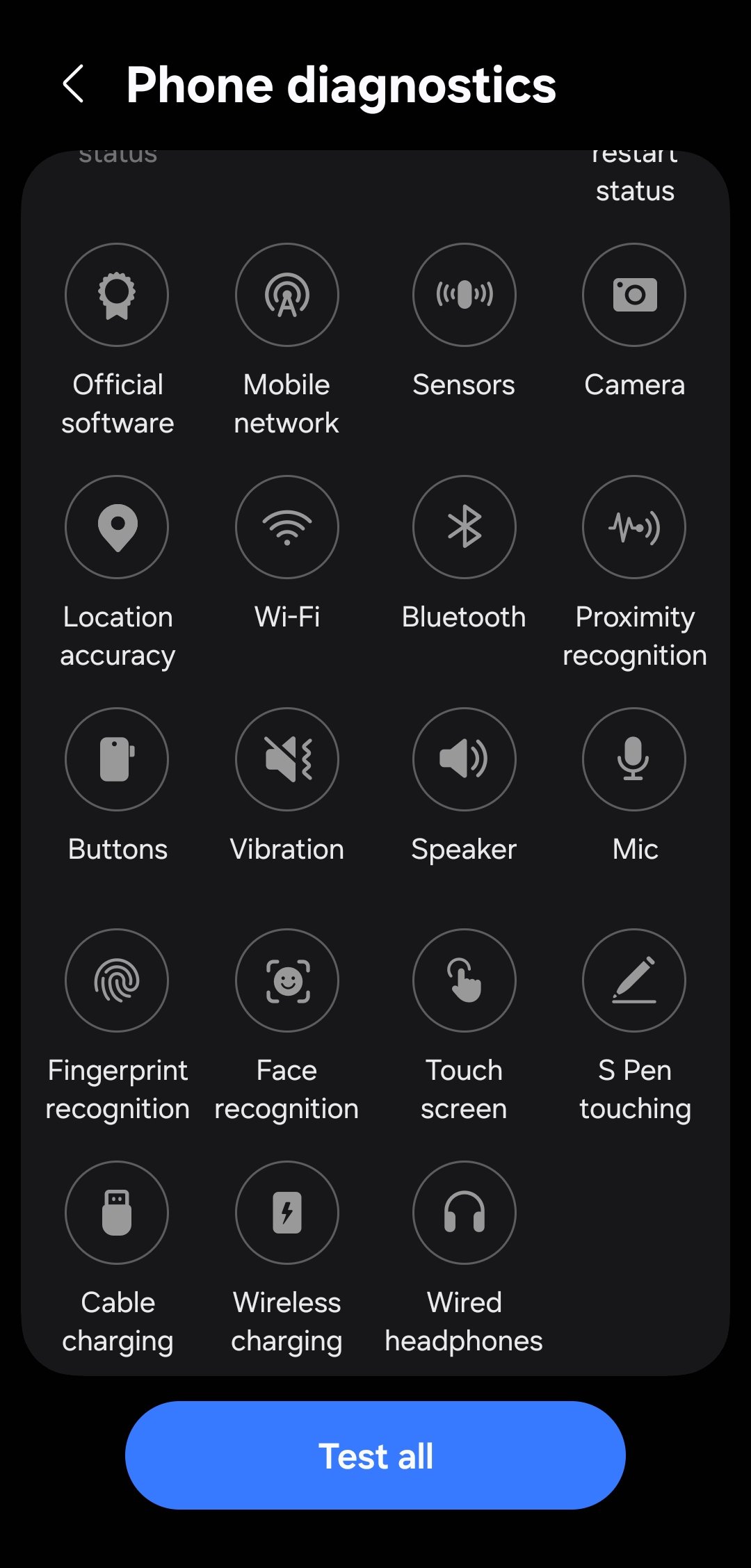

Both,car,charging phone have problems. 69%,79%,80% inaccurate stop work charging. Restart all over ,refresh system, troubleshooting etc, system ui isn't read charging it annoy it. Running diagnostic carefully read. Ain't lie to you
Make sure the charger port at the bottom is free from debris and get an original cable and charger to test if works , otherwise try diagnostic menu for battery and cables either in settings>device care>diagnostic or Samsung members app if it doesn't show in settings
Otherwise you need a repair shop to do further diagnostic
I did. It same . Turn on charging
This device is old enough to be malfunctioning due to wear and tear. It looks like it is dicontinued on Samsung's site. The repair cost may be almost as much as a new low end device. That may be another option to consider.
