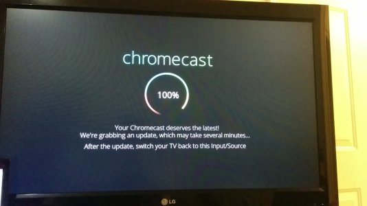

It seems to ber an issue with the internal antenna Mine was stuck for almost an hour barely moving and I only have one tv with an HDMI so moving my tv was out of the question and my router is in my office more than 20 ft away so here is my fix..... Grab a piece of copper wire about two feet long, and wrap it around your chromecast device. The update will complete in a blazing fast time. I used a piece of solid ground wire that is used in home wiring but in theory any wire will help boost the antenna strength. I went from 12% to 100% in seconds 1417881899065.2.jpg
