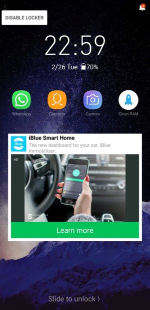

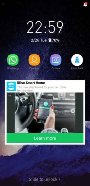

I have the same problem with my S9+, and I dont see Cool LED on the app list.
On the top left corner, I have a button with 3 dots, if I click on it, it shows "Disable Locker"
Any idea how to remove it?

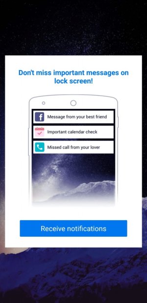

WhatsApp Image 2019-02-26 at 22.59.15.jpgWhatsApp Image 2019-02-26 at 22.59.15 (1).jpgWhatsApp Image 2019-02-26 at 22.59.15 (2).jpg
Try to press on the clock, on the date, on the application. Maybe when you click on one of them, the system will ask you for the right to access contacts, camera or location. And it is in such a request that the program must be indicated, which will require such rights. This will be a parasite program.
I think I found the app. It is the Smart Screen app. I had the same problem, found a way to force it to ask for permissions to something and then delete it, the screen is gone. I also removed all the other Smart Apps except the ATT one, figured it was normal and hadn't used anything.
So try uninstalling SMART SCREEN in APPS, that should solve it.
