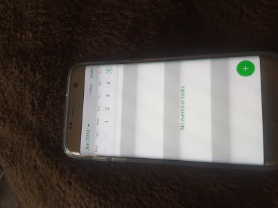

i have the very same issue. Only had my phone for a few weeks and it just happened today. I have not dropped it or got it wet or anything it just suddenly changed.20160605_182911.jpg

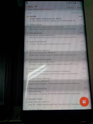

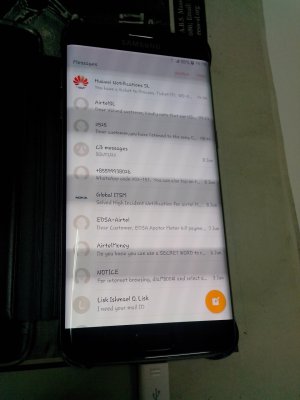

Hi All, My S7 Edge just have the same problem since 2 days ago.
If you go outside on daylight, and put on automatic brightness, the line disappear.
I feel it is a range setting done on the sensor which has to be corrected... or the threshold of the sensor has shifted. Or the senso has been damaged (which should not be the case for such a big brand like Samsung who use a high quality kind of materials reflecting the high and expensive price).
Hope Samsung will reply to all of us why this is happening, and give a very acceptable solution.
And the interesting thing is that the lines are not captured by a screen shot, hope all of you can confirm.
