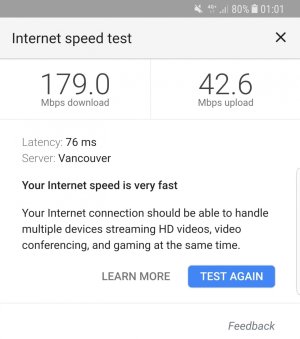

OK here's an update. I managed to solve the problem without doing a factory reset.
I just went in and cleared all network settings and re-entered everything manually. Rebooted the phone and not only is LTE back and working fine, I'm getting the fastest LTE speeds I've ever had!
