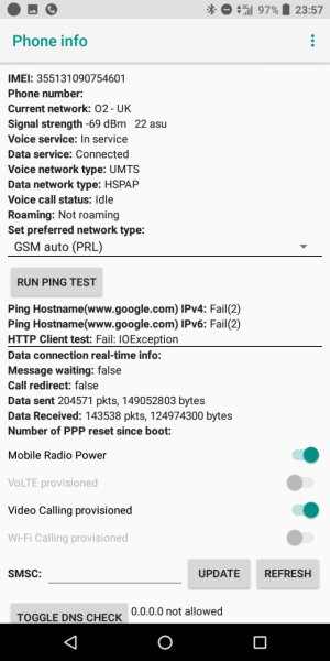

I just tried the suggestion below - I can't remember what option was selected on the drop-down menu before I selected GSM Auto. Now my phone appears to be getting 3g exclusively despite it being on 2g/3g/4g auto. When I tried to fix the issue before by using 3g only the issue still existed.
I ran a ping test before I changed the setting and I had a connection in SIM slot 1 (I'd just used airplane mode so hadn't switched itself off yet) and it said it was fine.
However, when I selected the GSM Auto and did the ping test they both failed, but when I exited and opened chrome it loaded fine (on 3g though). Should I be able to use data after a failed ping test?
Does this tell you guys anything? I really don't know what I'm doing/looking at.
I screenshotted the failed ping test which I've attached. What does that mean? Do I need to change anything back or take any action knowing that now?
Thanks so much for taking the time to reply guys :)

OK. Progress.... Ish.
So, when I'm on that ping test page and set my preferred network type to GSM Auto (PRL) I seem to only get 3g but, more importantly, it holds signal like it should
However, whenever I restart my phone or even just close the testing tab in the background it defaults straight back to LTE/UMTS auto (PRL). Which appears to be the problem.
Is there a permanent way to do this so I can change these settings and save them?
Also if GSM is working without issues, does that narrow down my problem and prompt any more fix suggestions? Where I'd have 4g?
