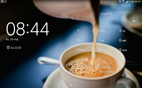

Hey guys, first post here... The screen died on my tablet and I'm sending it in to Samsung for service. I want to recover my data before I send it off but it's PIN protected and I can't unlock it so that it will communicate with my computer. I can tell the touchscreen is still working because I can feel the haptic feedback. I'm wondering if someone can send me a screenshot of their PIN lock screen so that I can print it out and lay it over the screen to tell where the buttons are. Any help would be greatly appreciated.
Here u go:
