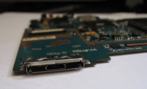

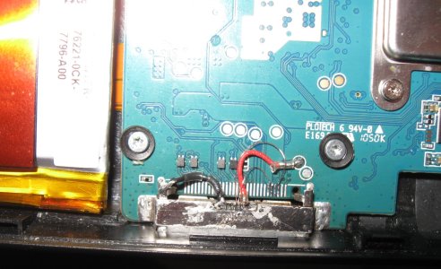

Guys thanks for ideas here my version of my Mod
Only problem I have is when power on an connected to PC it does show charging in Android but the charge light is lit.
When connected to ac charger and power on it shows charging in Android. Might need 1 more wire connected to enable charge status with PC. But I have it charging and detected by PC I'm happy.

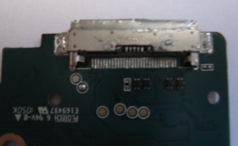

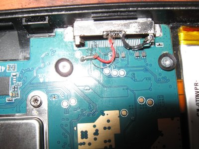

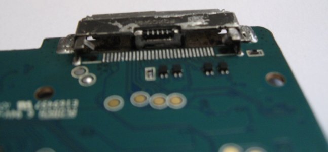

Here is the front of the main boards PCB, the red wire is attached to one of the circle mount points to the right of the connectors port (either circle should be fine, both are positive and connect to pin 1 of the PDMI) the Black wire is attached to one of the grounding points of the connectors shield.
https://sphotos-b.xx.fbcdn.net/hphotos-ash3/530530_10151407605719374_857703659_n.jpg
On the back above the cutout for the connection port there are 2 more circle mount points. the left being for the Data - (green wire) and the right being for the Data + (White Wire)
https://sphotos-a.xx.fbcdn.net/hphotos-snc7/481241_10151407605934374_1632313913_n.jpg
That's it for now, hope this helps. I'll be redoing this later tonight with the micro USB port (hope it fits, it should) and I'll try to get some better pictures.
Also sorry for the sloppy soldering job shown, I was just more or less in a rush, and knew I was coming back to the solder when the micro usb port arrived.
Also I make no guarantee about this, it's more or less do at your own risk. I can just say it worked for me ^-^ can't see why it shouldn't for you, but can't guarantee it
