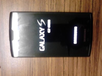

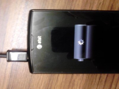

I have tried going into download mode and failed, I also tried going into recovery mode and failed.
Is my phone brick? How do I fix this?
Turn off the phone, take out the battery.... Wait a couple minutes re-insert the battery... Press volume+ and volume - at the same time and insert the phone cord into the phone keep on holding... Should go into download mode.

Then I would try a jig... And if that doesn't work... Jtag is the last chance to fixing it

I have tried going into recovery but it just reboots and is stuck at the screen again.
