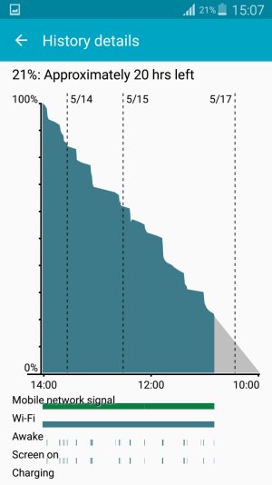

I didn't use my phone much, only about 1 hour SOT per day and I only turn on Wi-Fi when I needed, the rest of time I always keep it off, but today I checked my battery status and saw this
As you can see, my Wi-Fi bar show a straight blue the whole time even when Wi-Fi is off. It didn't make any sense.
Anyone know wht happened to my Wi-Fi and how to fix it?

I think it's just a glitch in the battery stats after Lollipop. My phone does the same sometimes and I haven't found a reason or a fix.
Did this hapened on Kitkat?
I don't know much about Kitkat because I updated my phone to Lollipop right after I bought it.
No. For me that happened just after Lollipop. For others reasons I've wiped the cache partition a couple of times after the update and it didn't change anything. I've checked my battery stats now and after being on mobile for a couple of hours the WiFi bar is on all the time. I sort of gave up trying to fix or even understand that glitch :)
Also, does it go away after a reboot?
Yeah, after I restart my phone the wifi bar is gone (I didn't use wifi at that time) but just 1 or 2 hour later it turn blue again (I still didn't use wifi) and problem remain.
Maybe it's Lollipop bug like Javier P said :(
I checked again. I left the phone on airplane mode for the night, you can see the gap in the cellular signal. And the WiFi bar is on all the time.

Thanks Javier P, now I know it's not just me having this issue, but why Samsung didn't fix it?

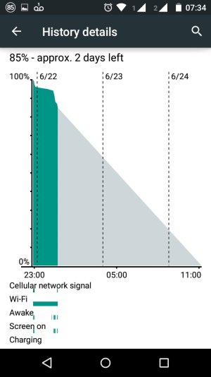

I've posted in other threads on this issue, but what worked on my HTC m9, nougat 7.0, was to toggle Extreme Battery Saver on then off again. I tried everything imaginable too, at first.
Another idea that struck me, was what I did after updating to nougat. I had to Reset All App Preferences, in the app manager. This is like one step below a Factory reset. It takes time to readjust all permissions later, and not just user land apps, but system too. This is definitely something to do after a bad ota update.
