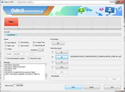

Re: Do I need to Root my Samsung Galaxy S5 SM-G900H to install lollipop rom

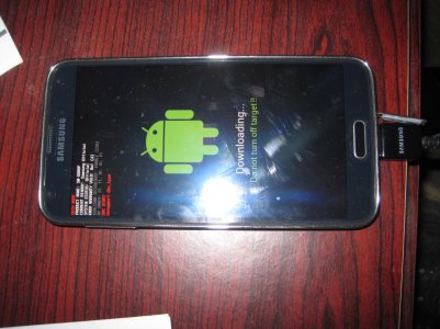

ok. I tried to flash the rom suggested by you and below is the snapshot it failed. Does usb port make any difference I am using 3.0 available on the front panel of my pc does it need to be 2.0 usb. Please Expedite
I see that your phone has been rooted before. Probably 4 times, according to your Knox Security counter.
Try different USB ports but do not connect via a hub. Make sure you use the USB cable that came with the phone. Make sure that you have the Samsung Kies PC suite installed but NOT running as Odin uses the drivers.

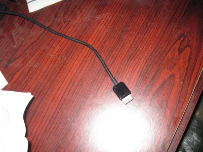

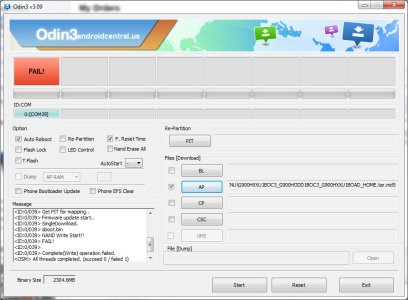

I tried different USB port but it's still shows FAIL also I am using the samsung USB cable. Below is the snapshot.
If you see in the above snapshot it fails after "NAND Write Start!!" in the Odin there is an option to select "NAND Erase All" should I check that box to fix the FAIL Issue.
That's odd! My stock Samsung Galaxy S5 USB cable looks like this...
https://www.uk-mobilestore.co.uk/in...a-cable.html?gclid=CJyGw_GotMYCFQfKtAodG2YJaQ
Try uninstalling the Samsung Kies3 PC Suite and the Samsung drivers from your computer. Reboot and then re-download the Samsung Kies3 PC Suite again. Do not have it running when you use Odin.
You can also try re-downloading the Samsung firmware in case you have a corrupt download.
Have you, in the past, played around with flashing a different .PIT file during the many rootings on your phone?

Looking at your photo again in your post #10, you have do not appear to have the octa core, non 4G variant, G900H as per your post #6 and thread title, but it would seem that your phone was, originally, the USA model for the carrier, "SPRINT", on model # G900P.
Check out the Product Name in your photo. This explains why you have been getting issues as the phone appears to have been rooted and a customised ROM of some sort, for the G900H model, has been flashed to it, possibly to get it to work on the local networks. This is the second time today that a phone has turned out to be something other than it appears. See, here.

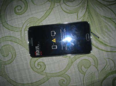

ok. As I mentioned in my early post that I got my cousin to buy this phone for me when she recently travelled to China so I believe it's not a new phone but a refurbished one and that the reason it shows a different model in download mode and different on the box. Now post trying to flash the firmware when I am trying to switch on the phone, I get the below message. I thought of saving few bucks and ask my cousin to get it from China at a cheaper price but it turned out to be this faulty phone. It's very painful, that I spent around 308 dollars and it's not even a month and it stopped working. Please suggest some solution now to fix this issue. Really appreciate your help on this.

DO NOT TRY AND FLASH A STOCK SAMSUNG FIRMWARE TO THIS PHONE!
This phone has been rooted, several times, and adapted, it would seem, to run on the, "H", model firmware. The only thing I can suggest is that you boot into Recovery Mode and wipe the Cache Partition, as per #1.3 of S5 Lollipop Update Problems - Dummies Guide

ok. I tried to enter the Recovery mode by pressing, Volume UP + Power + Home button but it shows me the same Firmware Upgrade Encountered issue screen. Any other way to recover the phone.
A Factory Data Reset would be my next suggestion, as per post #2 of S5 Lollipop Update Problems - Dummies Guide. However, all my suggestions are based on phones running stock Samsung firmware, which yours is not.

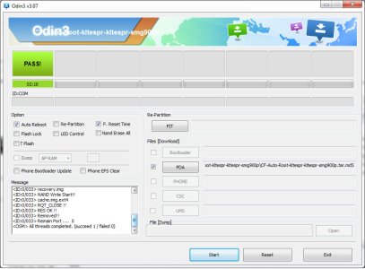

Is there no way I can bring back my phone to life. I did some google search and since my model is G900P, I tried to find the something for the same and below is what I got.
forum.xda-developers.com/showpost.php?p=51421228&postcount=3, I downloaded SM-G900P (Sprint): CF-Auto-Root-kltespr-kltespr-smg900p.zip file from the aforementioned link and tried to flash the same with Odinv3.07 and below is what I got. It shows past but the phone screen shows. What next, does this give me a chance to do something further and recover my phone completely. Please expedite
RECOVERY BOOTING...
RECOVERY IS NOT SEANDROID ENFORCING
Set Warranty Bit: recovery
Can I now go ahead and download the firmware for G900P from below link and if yes, which one.
