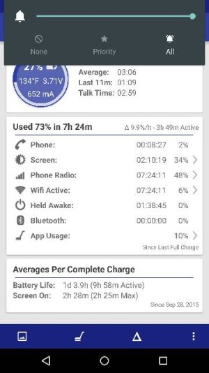

Hot hot phone
This afternoon 30 min surfing the Web

Re: Hot hot phone
134 degrees this is just way to hot just surfing the Web. On lte using att service love the phone but think the heat is going to kill the phone.
