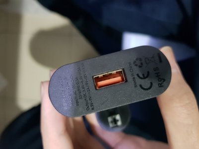

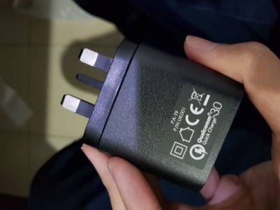

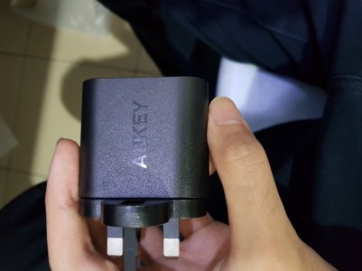

Hmm,not sure but here are some pictures in case you're curious and want to get it.The charger is also a lot cooler and my phone as well.Kinda great to know my battery ain't heating up that much compared to the original charger which is good for the longevity of the phone/battery and the charger it's self.
